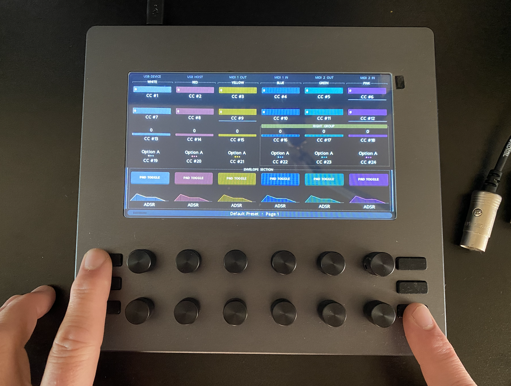

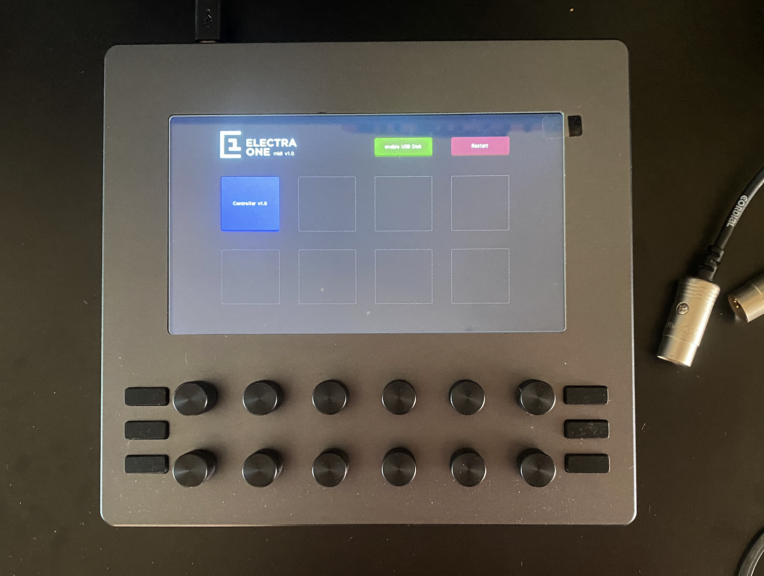

3. Switch to the bootloader mode
4. Enable the USB Disk option

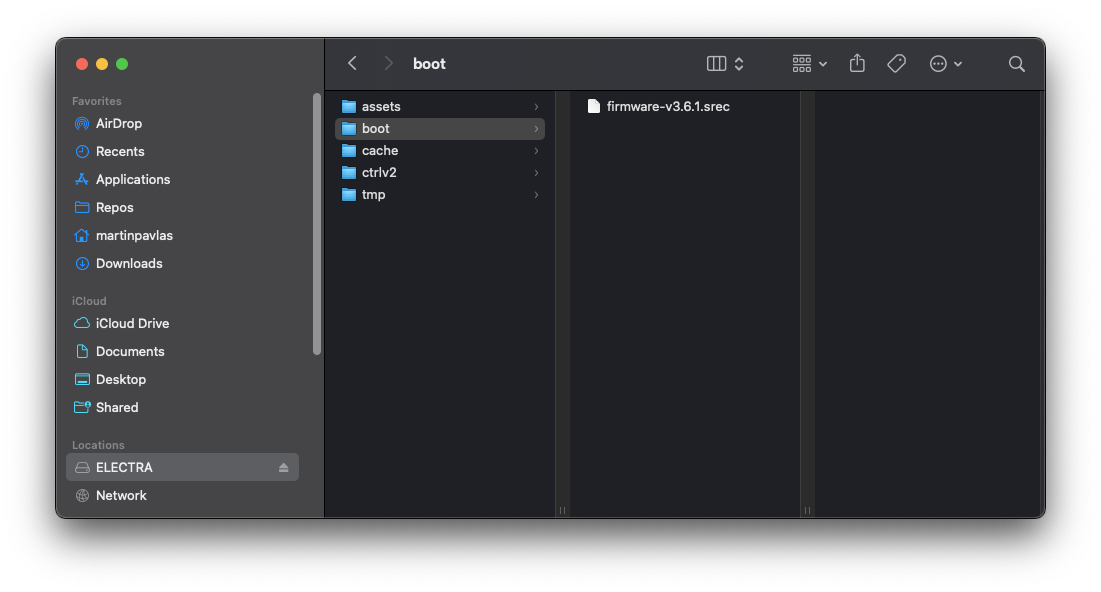

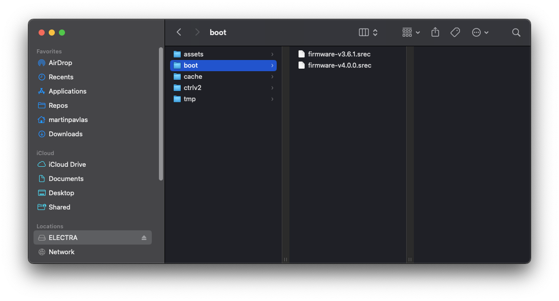

5. Copy the update file to the boot folder
Copy the firmware-v4.0.0.srec file you downloaded in step 1 into the boot folder on the Electra One disk. This process may take a few moments to complete. Note: You may see other files already present in the boot folder — it’s perfectly fine to leave them there.

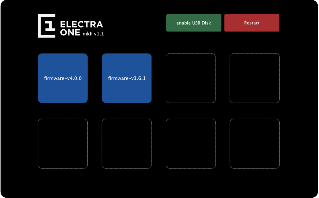

7. Start the bootloader again
The bootloader will start, and firmware-v4.0.0 will appear in the list of available firmware images:
Firmware uploaded
8. Apply the update
Tap the blue tile labeled firmware-v4.0.0 to begin the update process.
