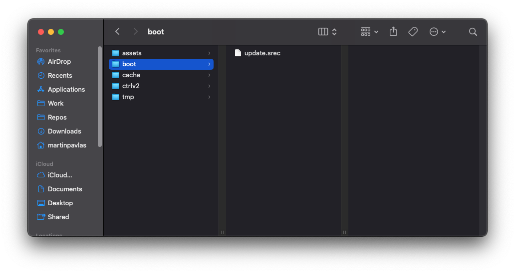

3. Use the Mini's USB disk ​
When the controller starts in bootloader mode, the display will show: USB DISK MODE. Electra One Mini will appear on your computer as a USB storage device:
Bootloader disk
  • Rename the firmware file: firmware-mini-v4.1.4.srec to update.srec
  • Copy the update.srec file into the /boot folder on the Electra One Mini USB disk.
Bootloader disk
