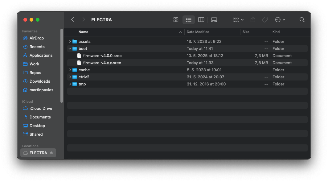

5. Copy the update file to the boot folder ​
Copy the firmware-mk2-v4.1.4.srec file you downloaded in step 1 into the boot folder on the Electra One disk. This process may take a few moments to complete. Note: You may see other files already present in the boot folder — it’s perfectly fine to leave them there.

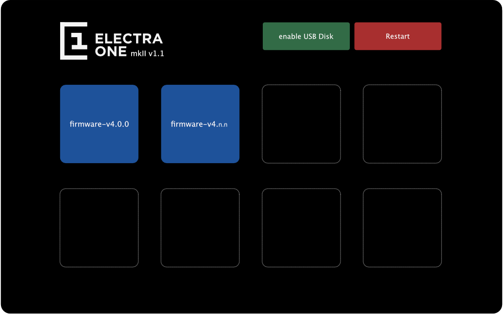

7. Start the bootloader again ​
The bootloader will start, and firmware-mk2-v4.1.4 will appear in the list of available firmware images:
Firmware uploaded
8. Apply the update ​
Tap the blue tile labeled firmware-mk2-v4.1.4 to begin the update process.
