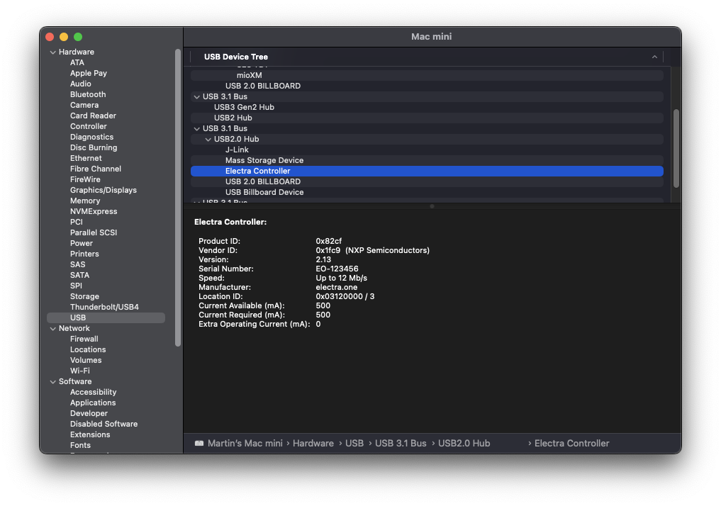

  1. Check if Electra One appears as a USB device
    Before troubleshooting MIDI or software:
    On MacOS:
    • Open System Information → select USB from the sidebar.
    • Look for a device labeled Electra One under the USB tree. System Information
    On Windows:
    • Open Device Manager → expand the Universal Serial Bus devices section.
    • Look for a device labeled Electra One or similar.

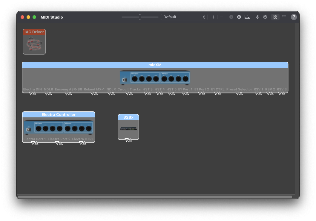

  2. Verify MIDI ports are present
    On macOS:
    • Open Audio MIDI Setup → Window → Show MIDI Studio
    • You should see Electra One with three virtual ports.
    • The Electra Controller CTRL port must be present and responsive. MIDI Studio

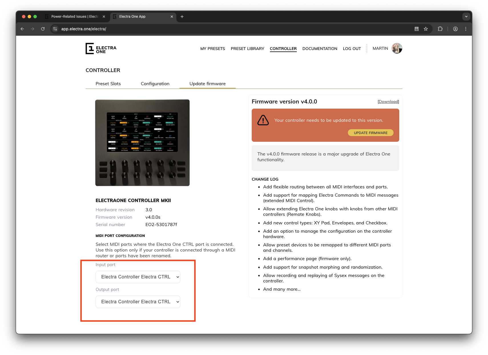

  3. Confirm Electra One Web App MIDI Setup
    In the Electra One Web App:
    • Click the Contoller in the top Menu
    • Under MIDI PORT CONFIGURATION, make sure the Input and Output ports are assigned to:
      • macOS: Electra Controller CTRL
      • Windows: Electra Controller (MIDIIN3) / ... (MIDIOUT3)
    MIDI Studio
    If ports are assigned incorrectly or blank: - Reassign them using the dropdowns. - Refresh the browser page after making changes.
