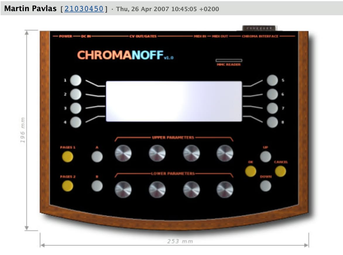

One example is particularly relevant to the Electra One story. The mighty Rhodes Chroma, introduced in early 1982, featured Chromaface - a hardware interface and proprietary protocol that allowed two Chromas to be interconnected or for patches to be programmed from a computer. Systems like this demonstrated that the need for digital communication already existed, but they were limited to specific instruments and manufacturers. MIDI resolved that limitation once and for all by introducing a universal, manufacturer-independent standard.
The Electra One project itself originally evolved from a hardware programmer built for the Chroma via Chromaface. In its earliest form, it was designed exclusively for the Rhodes Chroma before eventually expanding into a universal MIDI controller.
Chromanoff
Rhodes Chroma programmer (later became Electra One)

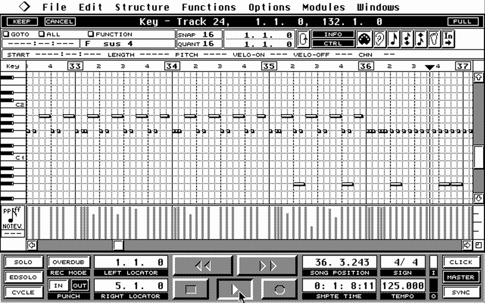

Another important milestone came in 1985, when the Atari ST computers were released with built-in MIDI ports. This brought MIDI to a much broader audience of musicians and producers. For the first time, a computer could be connected directly to synthesizers without the need for additional hardware interfaces and at relatively affordable price.
The Atari ST laid the true foundation for computer based music production and for the development of audio software and DAWs as we know them today. Sequencing, editing, arranging, and automation, all core elements of modern workflows, were already present in those early systems. Surprisingly, despite the immense technological progress since then, many of the concepts introduced by early Atari ST MIDI sequencers still feel remarkably familiar:
Chromanoff
Steinberg's Cubase running on Atari ST
