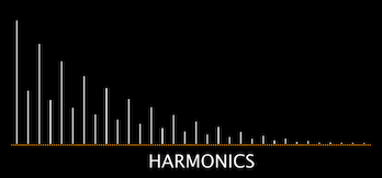

Custom Controls ​
Custom Controls are a special type of Control that give users full freedom to define their visual appearance and behavior using the Electra One Lua Extension scripting language.
Custom control
With a Custom Control, you can design entirely unique visual elements, handle input from both touch and knobs, and define how the control reacts to changes or incoming MIDI messages, all through Lua code.
This type of Control is ideal for advanced users who want to go beyond the standard control types and create highly specialized interactions or displays.
Custom Controls are most often used for:
  • Creating non-standard visual layouts.
  • Handling complex or device-specific Controls.
  • Building dynamic or animated control surfaces.
