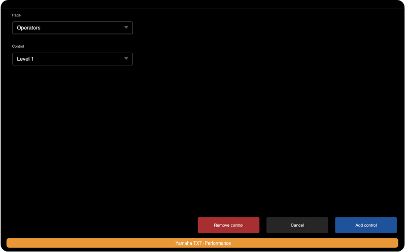

A simple reference allows you to place a copy of any control from your preset onto the Performance page. This type of reference is ideal for gathering frequently used controls in one place, without altering the original preset layout.
When added to the Performance page, a simple reference mirrors the following properties of the original control:

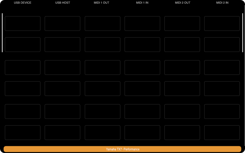

Fixed Layout
Performance page references are intentionally isolated from dynamic layout changes made to the original control via Lua. This means the position, size, and visibility of a reference on the Performance page remain constant, even if those attributes are dynamically modified in the original preset.
This behavior ensures that controls on the Performance page maintain a stable visual layout, which is essential for live use, and for features like Remote Knobs, where grid position determines MIDI CC mapping. Users can rely on each reference to remain in a fixed slot, ensuring predictable and consistent behavior.

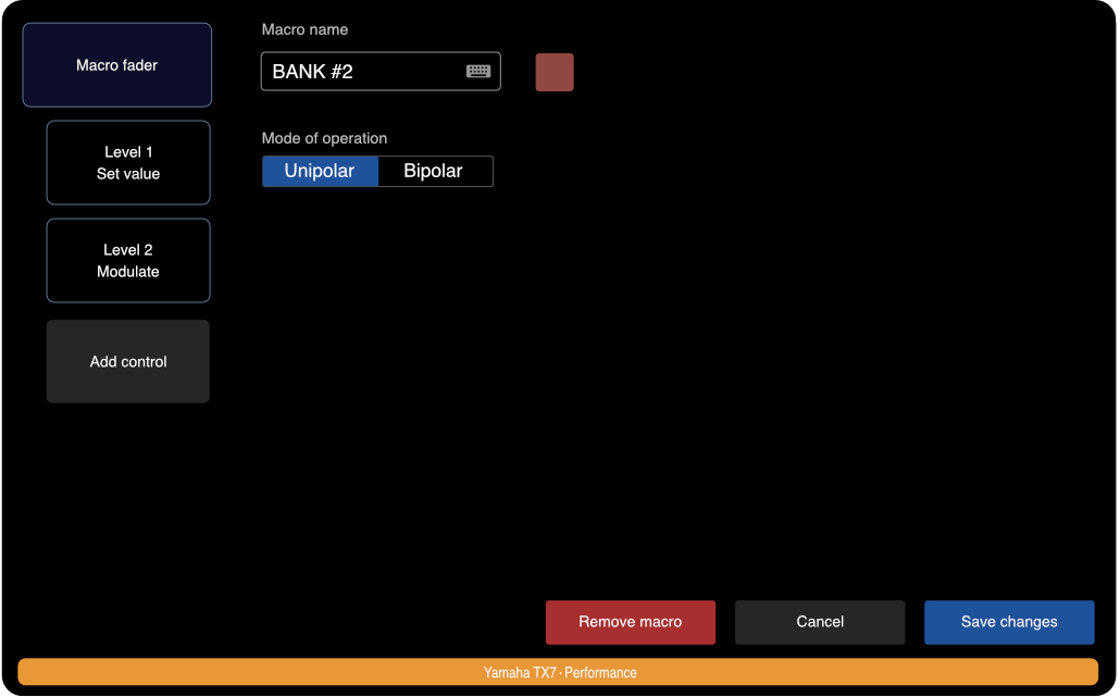

Multi-references are a powerful extension of the Performance page. Unlike simple references, which mirror individual preset controls, a multi-reference is a new control that can be used to modulate or control the values of multiple preset controls simultaneously.
Rather than referencing entire controls, a multi-reference targets individual values within controls in the original preset. For example, you can:
  • Use a single multi-reference to simultaneously adjust the Attack and Release of an ADSR envelope.
  • Control multiple faders together with a single macro-style knob.
  • Apply modulation across several parameters using one dynamic source.
This makes multi-references ideal for creating macro controls, enabling expressive performance techniques similar to those found on grooveboxes.

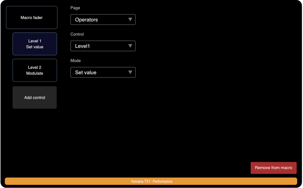

Each value targeted by a multi-reference can be assigned one of three value mapping modes, allowing for flexible control behaviors:
  • Set Value - the value of the original control is set directly, proportionally to the multi-reference’s current position.

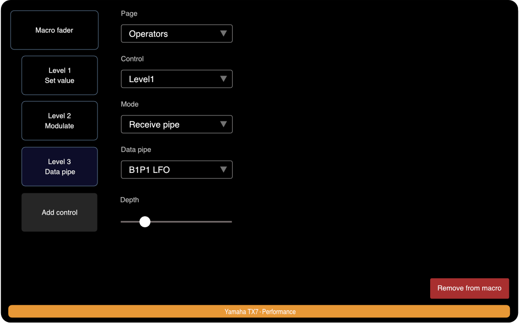

  • Modulation - the original control’s base value remains unchanged, but a positive offset (modulation) is applied based on the multi-reference’s value.
  • Datapipe - similar to Modulation mode, but the modulation amount is calculated as a product of: The multi-reference’s value, and a dynamic signal (e.g. LFO) from a Datapipe source, such as a MIDI LFO preset.

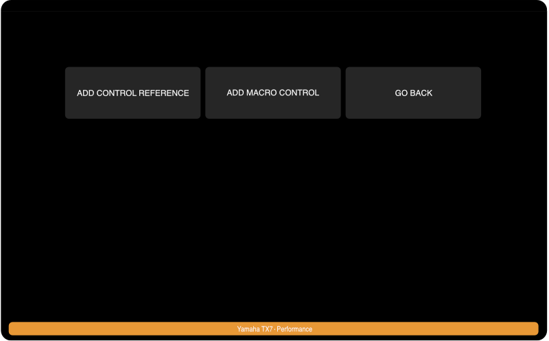

Toggling Performance
The Performance page is designed for quick access and smooth transitions during live use or studio work. You can easily switch between the Performance page and your regular preset pages using touch gestures or hardware buttons.
Accessing Performance

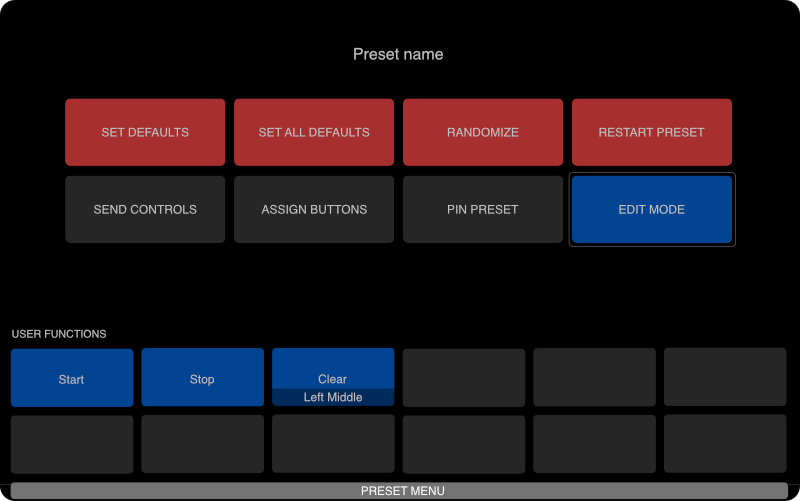

There are two ways to open the Performance page on the Electra One controller:
  • Swipe Gesture - swipe downward from the center of the screen. This gesture provides quick access without requiring any special configuration.
  • Hardware Button Assignment - assign the Toggle Performance command to any of the controller’s hardware buttons via the button settings. Pressing the assigned button will switch between the current preset page and the Performance page.
When the Performance page is active, it is clearly indicated by:
  • The word Performance displayed as the page title in the bottom bar.
  • An orange-colored bottom bar, distinguishing it from standard preset pages
Leaving Performance
To return to the regular preset page:
  • Swipe down again from the center of the screen
  • Or press the same hardware button mapped to the Toggle Performance command
Either method will close the Performance page and bring you back to your last viewed preset page.
