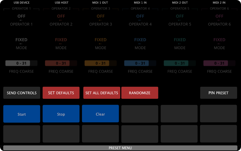

Preset Menu
The Preset Menu provides access to a set of actions related to the currently loaded preset. These actions help you manage control values, reset them, and trigger custom behavior.
Preset Menu
Available Actions:
  • Send All Control Values – Resend the current value of every control in the preset.
  • Set Defaults – Reset only the controls with a defined default value.
  • Set All Defaults – Reset all controls to their default or to zero if no default is defined.
  • Randomize Values – Apply randomized values to all preset controls based on their type.
  • Pin Preset – Keep preset running on background.
  • Preset User Functions – Access up to twelve user-defined Lua functions mapped to buttons.
Tapping the [SEND CONTROLS] button forces the controller to retransmit the current value of every control in the preset. This is useful for resynchronizing connected MIDI devices or reinitializing external gear.

When you pin a preset by tapping the [PIN PRESET] button, you instruct Electra One to keep that preset active in the background, even after switching to a different one. A pinned preset continues to:
  • Respond to incoming MIDI messages
  • Execute Lua functions, including timers and callbacks
  • Generate Data pipe output, such as MIDI LFOs, step sequencers, or automation sources
The preset stays pinned until you either unpin it by tapping the [PIN PRESET] button again, or you replace it by uploading a new preset to the same preset slot. In both cases, the pinned status is cleared and the preset will no longer remain active in the background.
Indicating pinned presets
When a preset is pinned:
  • The [PIN PRESET] button appears in blue and is highlighted with a light gray outline. Pinned preset button
  • In the Preset Selection window, pinned presets are marked with a small visual indicator, so you can quickly see which presets are currently running in the background Pinned preset

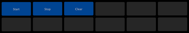

User Functions
User Functions are custom Lua functions defined by the preset developer to provide additional actions or behaviors tailored to the preset. These functions are registered in the preset’s Lua script using the preset.userFunctions table.
Up to twelve functions can be registered per preset, each represented as a button in the Preset Menu.
  • Buttons with an assigned user function are shown in blue
  • Tapping a button on the touchscreen triggers the corresponding function
  • If enabled in the preset’s configuration (see Pot Touch Selections under Settings → Interface), touching the corresponding knob can also trigger the function
User functions can perform virtually any task supported by the Lua environment, such as sending MIDI messages, triggering patch requests, adjusting control states, or interacting with external gear. This makes them a powerful tool for extending the preset's capabilities.
For more information on how to register and implement user functions, see the Lua Extension preset section of the Developer Documentation.
