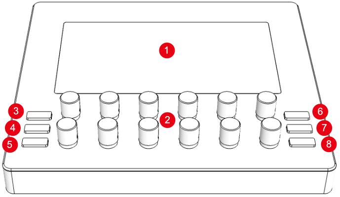

Front panel

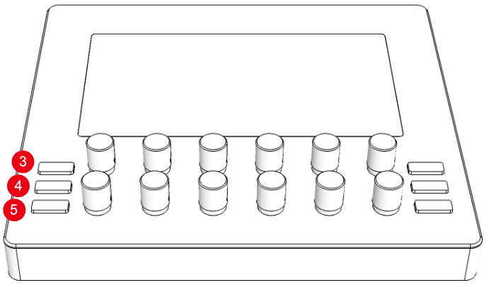

The front panel is where you interact with Electra One.
Electra front panel
  1. Touch-sensitive display – the main screen for interacting with controls, menus, and system features
  2. Touch-sensitive 360-degree knobs - labeled KNOB1 (top-left) to KNOB12 (bottom-right), used for adjusting parameter values
  3. [LEFT-TOP] button
  4. [LEFT-MIDDLE] button
  5. [LEFT-BOTTOM] button
  6. [RIGHT-TOP] button
  7. [RIGHT-MIDDLE] button
  8. [RIGHT-BOTTOM] button
In default configuration the buttons provide the following functions:
  1. [SECTION 1] button – activates the top row of control assignments
  2. [SECTION 2] button – activates the middle row of control assignments
  3. [SECTION 3] button – activates the bottom row of control assignments
  4. [PATCH REQUEST] button – sends patch request messages to connected devices

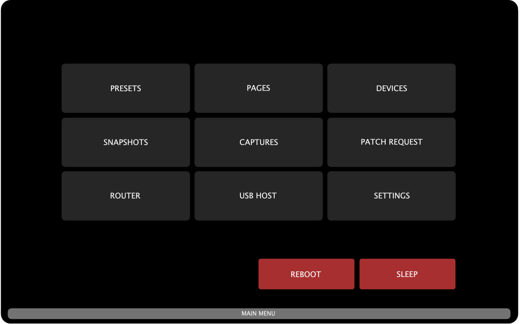

  5. [SNAPSHOTS] button – opens the snapshot management screen
  6. [MENU] button – opens the system menu for configuration and advanced options
You can customize all button actions in the controller’s configuration settings to better fit your workflow.

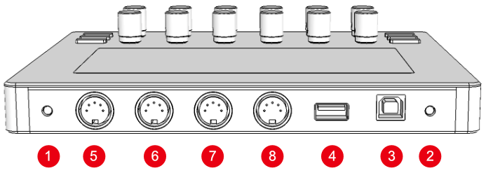

Rear panel
The rear panel is where you connect Electra One to your computer and other MIDI gear. It also includes buttons for resetting the device and initiating a firmware update.
Electra back panel
  1. [UPDATE] button – puts the controller into firmware update mode
  2. [RESET] button – performs a hardware reset
  3. <USB DEVICE> port - connects Electra One to your computer as a USB MIDI interface
  4. <USB HOST> port – connects USB MIDI devices (e.g. synths, controllers) directly to Electra One
  5. <MIDI 2 IN> port – standard 5-pin DIN MIDI input (Port 2)
  6. <MIDI 2 OUT> port – standard 5-pin DIN MIDI output (Port 2)
  7. <MIDI 1 IN> port – standard 5-pin DIN MIDI input (Port 1)
  8. <MIDI 1 OUT> port – standard 5-pin DIN MIDI output (Port 1)
Ports <MIDI 1 OUT>, <MIDI 1 IN>, <MIDI 2 OUT>, <MIDI 2 IN> are often referred as to <MIDI IO>

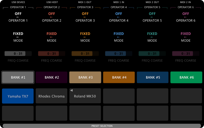

The leftmost item on the status bar shows the status and MIDI activity of the <USB DEVICE> port — that is, the communication between the controller and the computer.
USB Device port
USB Host devices
USB Host devices displays information about MIDI USB devices connected to Electra’s USB Host port. The MIDI USB devices are identified by their “Product name”. It means that when a USB device is connected to the <USB HOST> port, its name is shown.
USB Host port
Up to two USB MIDI devices can be connected using a standard USB hub. When two devices are connected, the label will read "2 devices".

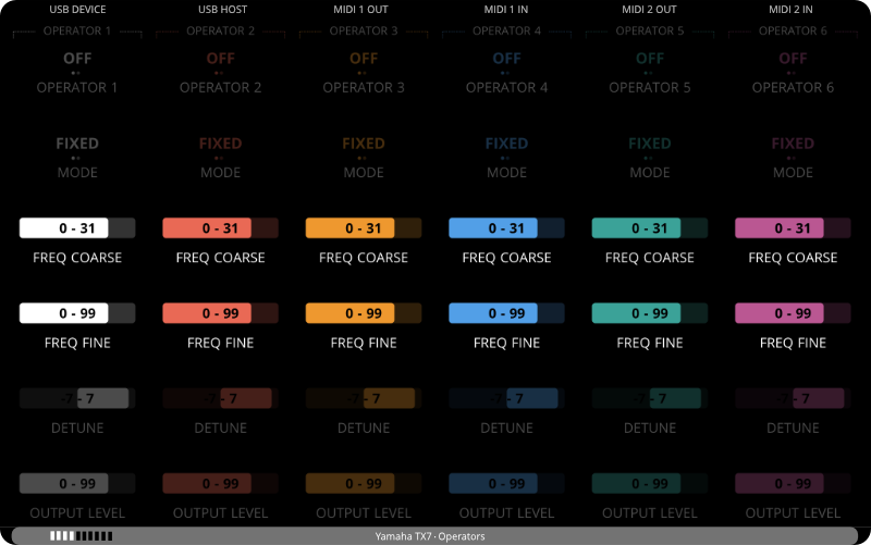

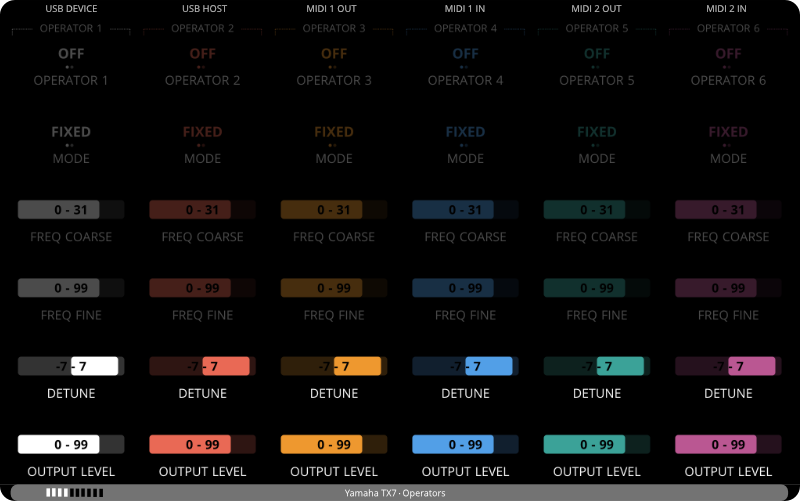

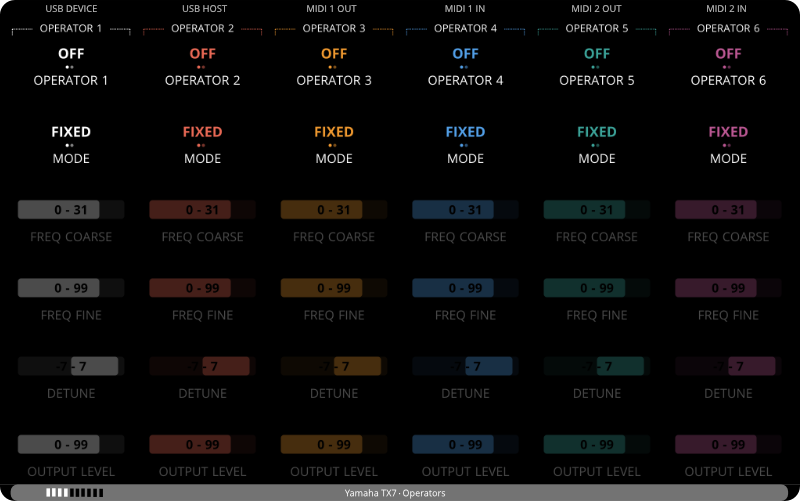

Active Control Set
Electra’s display can show up to 36 controls on a single page, but there are only twelve physical knobs. To make all controls easily accessible, the screen is divided into three sets — each containing up to twelve controls.
Only one set can be active at a time. The controls in the active control set are mapped to the twelve physical knobs, meaning that turning a knob will adjust the corresponding control’s value.
In default configuration, the active control set is selected using the three buttons on the left side of the controller:
Active control set buttons
  • Button 3, referred to as [SECTION 1], activates the top set.
  • Button 4, referred to as [SECTION 2], activates the middle set.
  • Button 5, referred to as [SECTION 3], activates the bottom set.
The active control set is always indicated by white bars along the left and right edges of the screen. These visual indicators help you stay oriented and clearly show which set of controls is currently linked to the knobs.
You can also switch the active control set by simply tapping a control on the touchscreen. The set containing the tapped control will become active. This feature is part of the default configuration and provides a quick, intuitive way to work with the controls.

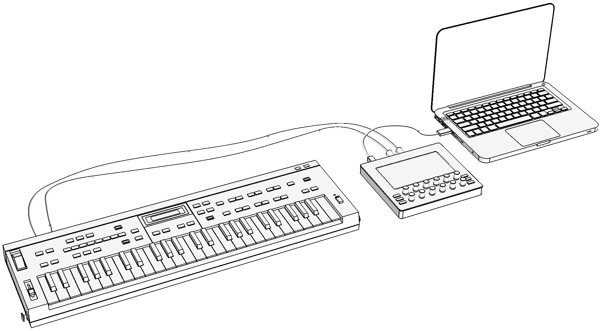

A basic setup
To begin with, the following setup is ideal:

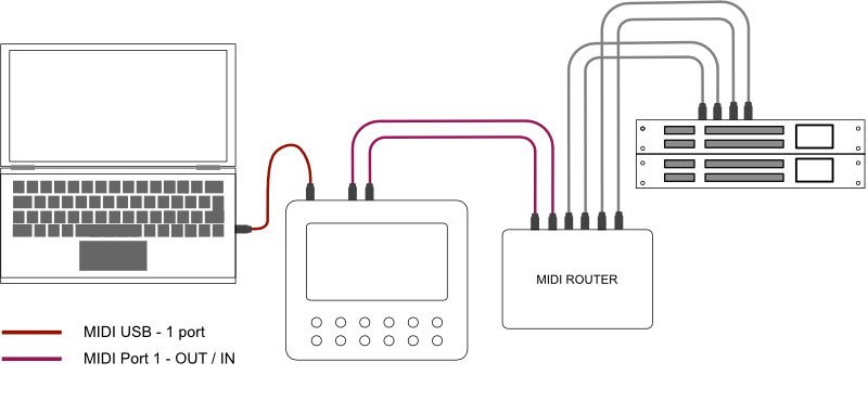

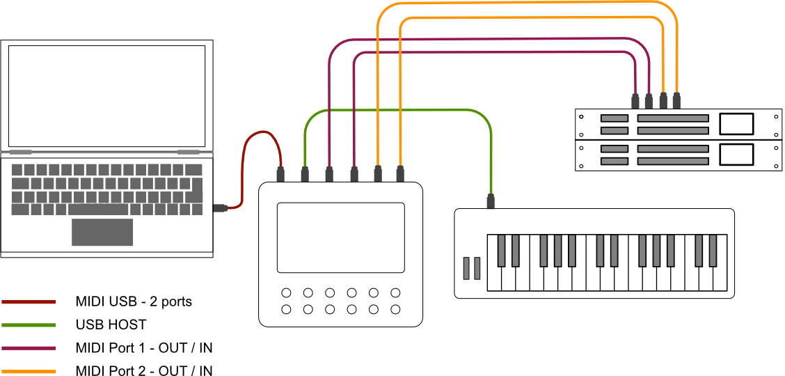

Electra with one synthElectra with one synth diagram
In this setup, Electra can control sound parameters of the synthesizer connected to <MIDI IO> port. You will see Electra' USB Device ports on the connected computers, we refer to them as <USB DEVICE>. These ports can be used to send and receive MIDI messages to and from the synthesizer. It means Electra acts here as a MIDI controller as well as a MIDI USB interface.
In this setup, Electra One controls the sound parameters of a synthesizer connected to its <MIDI IO> port. On the connected computer, Electra appears as a set of USB MIDI ports — referred to as <USB DEVICE> in this guide. These ports can be used to send and receive MIDI messages between your computer and the synthesizer.
In this configuration, Electra acts both as a standalone MIDI controller and a USB MIDI interface, seamlessly bridging your hardware and software. The USB connection to your computer can also be used to access the Electra One web editor for editing presets and managing your controller.
Electra One MIDI controller has three USB device ports. On MacOS they are:
  • Electra Port 1
  • Electra Port 2
  • Electra CTRL
On Windows, you will most likely see:
  • Electra Controller
  • MIDIIN2 (Electra Controller)
  • MIDIIN3 (Electra Controller)
By default, any MIDI message sent to USB device Port 1 OUT on the computer, will be forwarded to <MIDI 1 OUT> port. Any message received on <MIDI 1 IN> port, will be forwarded to USB device Port 1 IN on the computer. Ports 2 work in the same way. The routhing of messages between the MIDI interfaces and ports can be fully customized by configuring Electra One internal MIDI router.
By default, any MIDI message sent from your computer to USB Device Electra Port 1 OUT is forwarded to Electra’s <MIDI 1 OUT> port. Similarly, any message received on <MIDI 1 IN> is forwarded to USB Device Electra Port 1 IN on the computer. Port 2 behaves the same way.
The routing of MIDI messages between Electra’s ports and interfaces can be fully customized using Electra One’s internal MIDI router.
Electra CTRL is dedicated to communication between Electra and Electra Editor.
If you do not see Electra CTRL, it might be called MIDIIN2 / MIDIOUT2. Some versions of operating systems do not read the port name correctly. Please review The Connection Troubleshooting Guide.

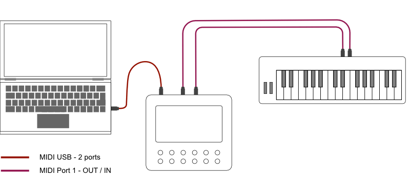

A complex setup
To illustrate Electra's capabilities let's take a look at a more complex setup:
Electra in complex setupElectra in complex setup diagram
Here we connect more gear to the <MIDI IO> ports. Next to that, the Master keyboard is connected to Electra’s <USB HOST> port.
In this setup, you can have full bi-directional control over two hardware synth modules. The MIDI messages generated by the Master keyboard are automatically forwarded to both <MIDI IO> ports and to the <USB DEVICE> ports.
MIDI messages generated by turning the knobs are being merged to the flow of MIDI data according to Electra’s settings. These messages will be sent to both <USB DEVICE> port as well as to <MIDI IO> ports.

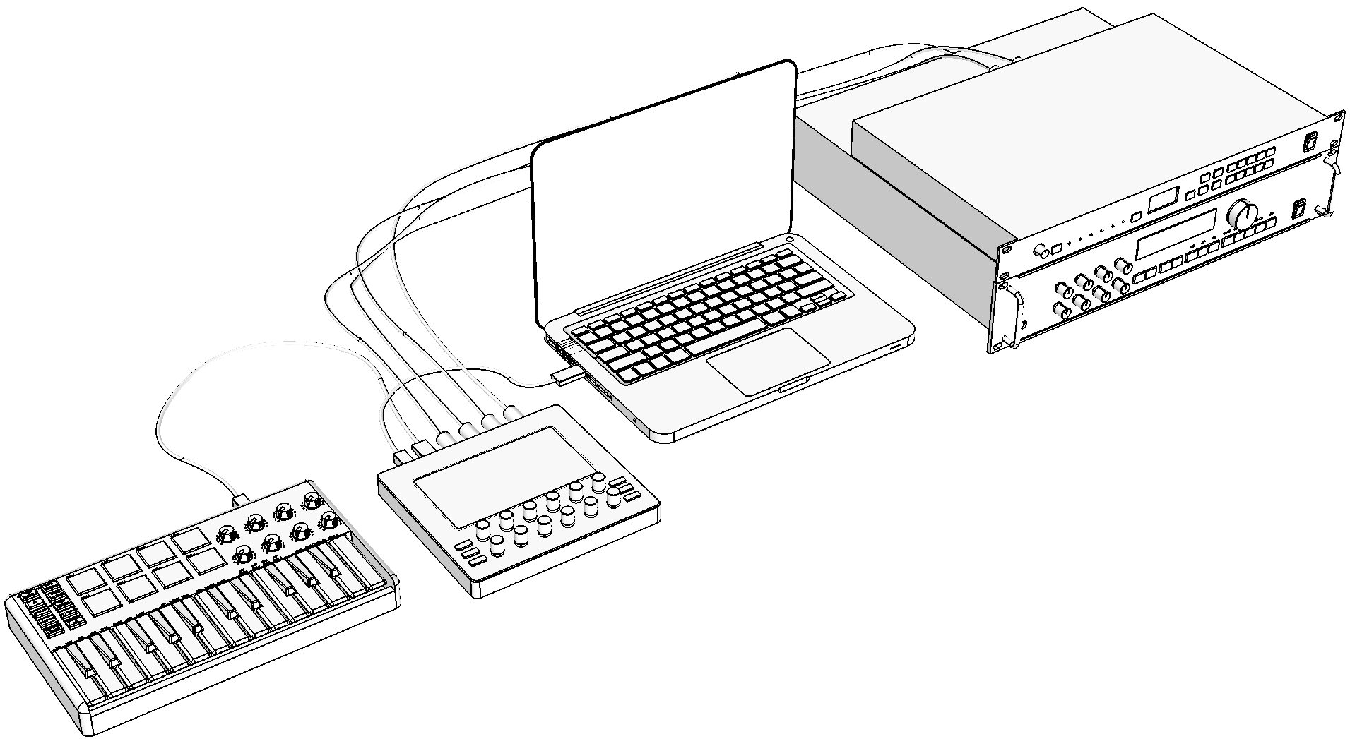

A MIDI router setup
Combining Electra One with a MIDI router, such as the iConnectivity series, Blokas MIDIHub, or Conductive Labs MRCC, creates a powerful and flexible MIDI system. This setup allows smooth control over multiple synthesizers and MIDI devices from a single controller.
A basic example of a MIDI router–based setup:
Electra in MIDI router setup diagram
In the example above, the <MIDI IO> ports were used to connect the MIDI router. However, you can also connect a MIDI router to Electra One’s USB Host port, or connect Electra One’s USB Device port to the USB Host port of the router.
If you connect Electra One to a USB Host port, make sure the host can supply 500mA of current. If it cannot, use a powered USB hub or a USB Y-cable to provide the additional power required.

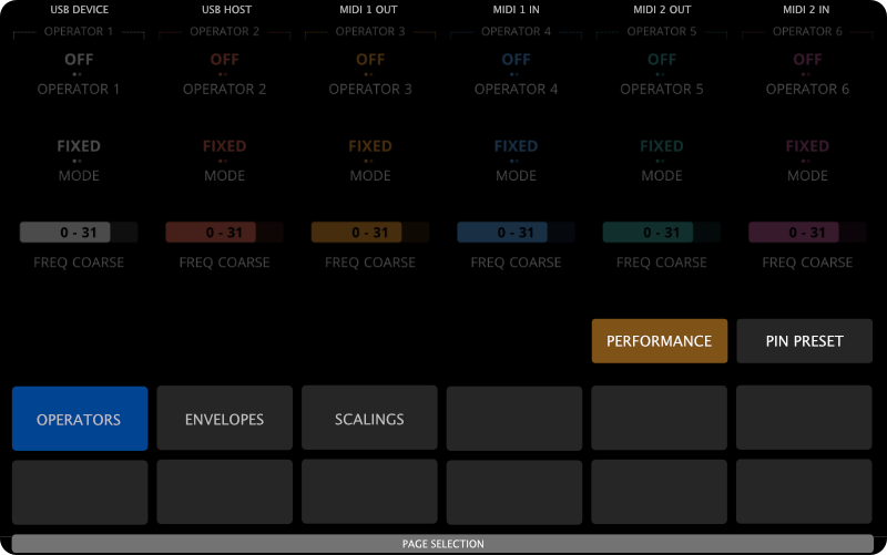

Changing pages
Each Electra preset can include up to twelve pages of controls. While pages can be selected through the main Menu, this action is so commonly used that it’s typically assigned to a dedicated hardware button. As we are using the default configuration now, the Page selection window can be displayed by pressing the [RIGHT-BOTTOM] button (8).
Page hint
If you simply press the button. The Page selection window will be openned and will stay open until you switch to any of the pages or you press [RIGHT-BOTTOM] (8) again.
Page hint
The currently selected page is highlighted (shown in blue). Page names are positioned on screen to align visually with the knobs, making it intuitive to select a page by either tapping the on-screen page button or touching the corresponding knob.
Tip: Press and hold the [RIGHT-BOTTOM] button to quickly preview all preset pages. While holding the button, simply touch any knob to view the page it belongs to.

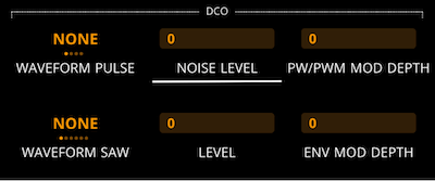

Active control
To make navigation easier, touching a knob highlights the corresponding control by underlining it on the screen. This lets you see which control is active — even if you don’t turn the knob. Multiple knobs can be active in the same time.
Active control
You can change a control’s value by turning the corresponding knob, or by swiping left or right on the control directly on the touchscreen.

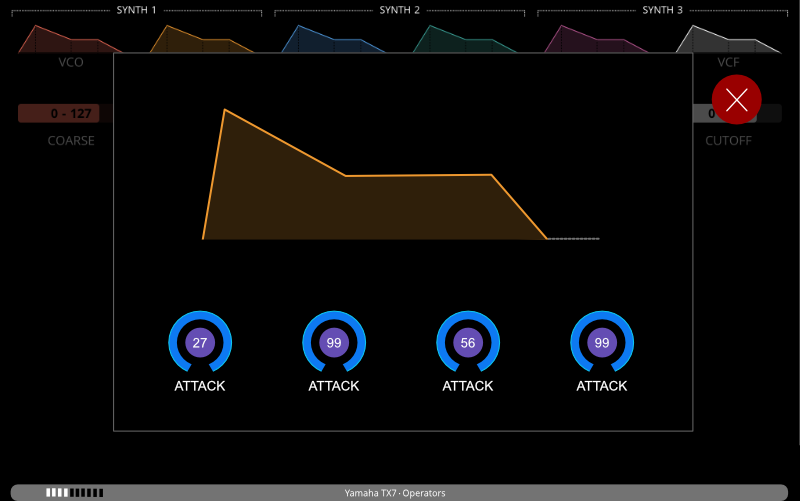

Envelope detail
The envelope detail view allows you to edit all envelope parameters in one place. When this view is active, Electra temporarily reassigns the knobs to control individual envelope values. These knob assignments are active only while the envelope detail window is open.

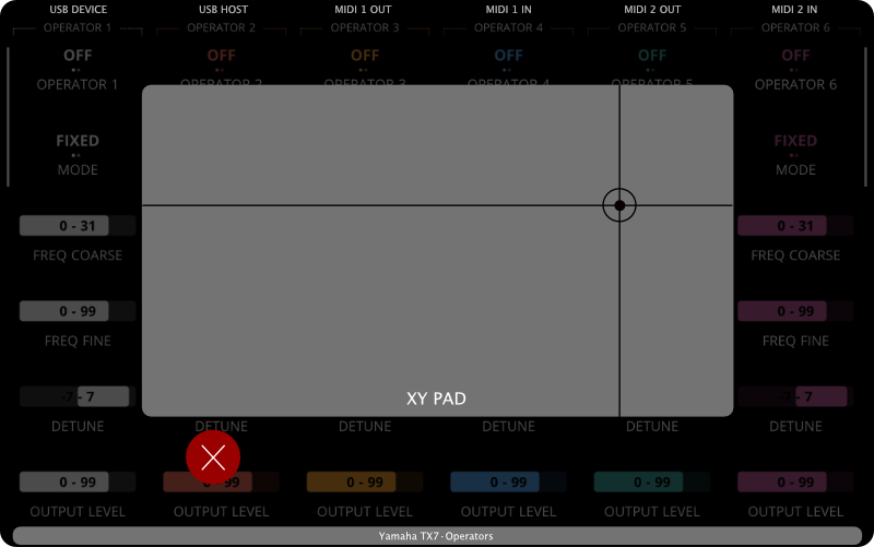

XY Pad detail
The XY pad detail view provides an interactive two-dimensional surface for controlling two parameters at once. Unlike other controls, the XY pad is operated entirely by touch—no knobs are used. You can move your finger across the pad to adjust both the X and Y values in real time.
List detail

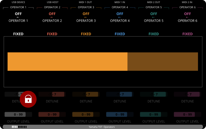

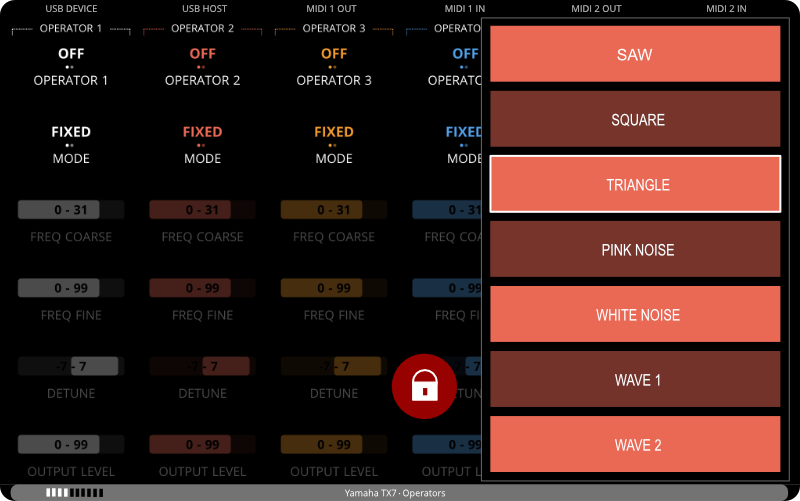

Locking the detail window
By default, the detail window closes immediately after a value is changed or a selection is made. In some situations, this behavior may not be desirable. To keep the window open, you can lock it by tapping the lock icon:
Lock disabled
When the lock icon is tapped, it becomes highlighted, indicating that the detail window is now locked. In this mode, you can make multiple changes without the window closing after each adjustment.
Lock enabled
To close a locked detail window, simply tap the lock icon again or tap anywhere outside the detail window on the display.
Detail window knob assignment
The detail window retains the original knob assignment, allowing you to use the same knob to adjust the control’s value even while the detail view is open.
Resetting to the default value
Double-tapping a control resets its value to the default setting defined in the preset.
Changing active value of multi-value controls
Some controls, such as envelopes, contain multiple values. When a preset is loaded, one value is assigned to a knob by default—this default assignment is defined in the Preset Editor.
However, there are situations where you may want to adjust a different value without opening the envelope detail window. In these cases, you can use a quick gesture to change which value is assigned to the knob.
There are two ways to switch the active (knob-assigned) value:
Touch and hold the envelope's knob (the control name will become underlined), then tap the envelope control on the display. The knob assignment will cycle to the next available value, which will be highlighted.
Touch and hold the envelope's knob, then press:
  • [SECTION 2] to move to the next value within the envelope
  • [SECTION 3] to move to the previous value
This allows quick switching between parameters like Attack, Decay, Sustain, and Release without entering the detail view.

Rear panel buttons
The [RESET] and [UPDATE] buttons are there to help you recover if something goes wrong. Since these situations are rare, the buttons are recessed and can be pressed using a pen or another thin object.
On newer Electra One units (2025 and later), the [UPDATE] button is no longer recessed — it sticks out slightly for easier access. In future firmware updates, this button may also support additional functions.
Reset button
The [RESET] button power-cycles the controller. Pressing it has the same effect as unplugging and reconnecting the USB cable.
Note: Resetting Electra will not delete any of your presets or saved settings. However, any unsaved values from the currently loaded preset will be lost.
It is always recommended to put Electra into Sleep Mode before resetting or disconnecting the USB cable.
Update button
[UPDATE] button is used to initiate a forced firmware update. Under normal circumstances, firmware updates can be initiated from the Electra One web application without pressing the [UPDATE] button. If, however, your firmware update fails or if you upload a corrupted firmware file to Electra and it becomes bricked, pressing the [UPDATE] will allow you to restore the controller to the working state. Full description of the recovery procedure is described at Firmware recovery.
