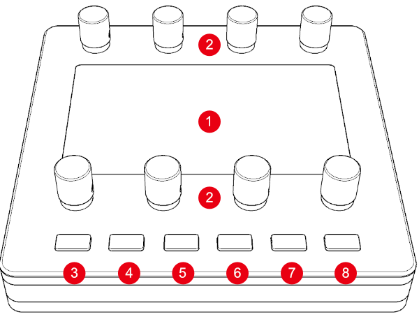

Front panel ​
The front panel is the primary area where you interact with Electra One Mini.
Electra front panel
It consists of the following elements:
  1. Color display – the main screen used to present controls, presets, pages, menus, and system screens.
  2. Touch-sensitive 360-degree knobs – eight rotary encoders labeled KNOB 1 (top-left) through KNOB 8 (bottom-right). These knobs are used to adjust parameter values, select and focus controls, and navigate the user interface.
  3. [MENU] button
  4. [CONTEXT] button
  5. [BUTTON 1] button
  6. [BUTTON 2] button
  7. [BUTTON 3] button
  8. [BUTTON 4] button

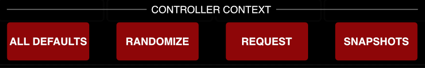

The [MENU] and [CONTEXT] buttons have fixed, system-level functions that cannot be changed by the user. The remaining four buttons can have their function assigned by the preset or a current context.
In the default configuration, these assignable buttons perform the following actions:
  1. [BUTTON 1] button – resets all preset controls to their default values.
  2. [BUTTON 2] button – assigns random values to all preset controls.
  3. [BUTTON 3] button – sends a patch request MIDI message.
  4. [BUTTON 4] button – opens the Snapshots window.
The actions assigned to these buttons can be customized in the web application, allowing you to adapt the behavior of the device to better suit your workflow.

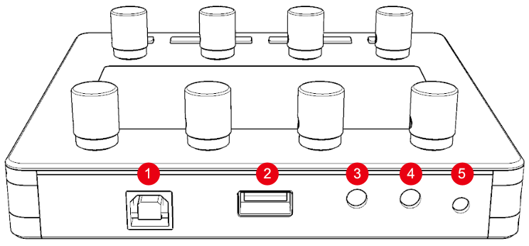

Rear panel ​
The rear panel is where you connect Electra One Mini to your computer and other MIDI gear. It also includes a button for resetting the device and switching it to the update mode.
Electra back panel
  1. <USB DEVICE> port - connects Electra One to your computer as a USB MIDI interface
  2. <USB HOST> port – connects USB MIDI devices (e.g. synths, controllers) directly to Electra One
  3. <MIDI 1 IN> port – MIDI TRS A input (Port 1)
  4. <MIDI 1 OUT> port – MIDI TRS A output (Port 1)
  5. [RESET] button – performs a hardware reset
Ports <MIDI 1 OUT>, <MIDI 1 IN> are often referred as to <MIDI IO>
Reset button ​
The [RESET] button power-cycles the controller. Pressing it has the same effect as unplugging and reconnecting the USB cable.
Note: Resetting Electra will not delete any of your presets or saved settings. However, any unsaved values from the currently loaded preset will be lost.
The reset button is not needed under normal circumstances. It is used to switch the controller to the update mode or to recover from system crashes.

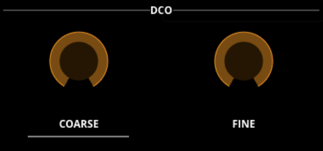

Controls are typically arranged in a 4 × 2 grid, providing direct access to eight primary controls. In addition, presets may define four soft pads at the bottom of the display, allowing access to up to 12 controls per page. Pads are button-like controls that are triggered by pressing the corresponding hardware button and are commonly used to send MIDI messages or trigger preset Lua functions.
More advanced presets can override or customize this layout to better suit specific workflows or device requirements.
  1. Status bar with MIDI port activity indicators
  2. Upper row of controls assigned to the top knobs
  3. Lower row of controls assigned to the bottom knobs
  4. Bottom bar with the preset name and current page name
  5. [MENU] button to change pages, presets, windows
  6. [CONTEXT] button to change function of the assignable buttons
  7. Assignable buttons, defined by the active preset or the current context
  8. Indicator of activity on <MIDI 1 OUT> port
  9. Indicator of activity on <MIDI 1 IN> port
  10. Devices connected to <USB HOST> port and indicator of activity
  11. Indicator of activity on <USB DEVICE> port
  12. Group of Controls
  13. Dial Control
  14. Mode indicators
  15. Preset name
  16. Current page name
  17. Optional info text defined by the preset

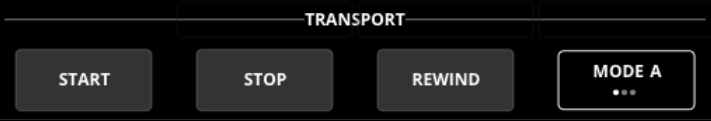

The Context ​
Context is a key concept introduced on Electra One Mini. It defines what actions are assigned to the four assignable hardware buttons, depending on what you are currently doing on the controller.
In other words, the same four buttons can perform different actions based on the current context, allowing the Mini to offer powerful functionality with a small number of physical controls.

  1. Preset context - In this context, the four buttons are defined by the active preset. Preset designers can assign actions to these buttons using the Web Editor, for example by placing Pad controls on them. The buttons can then be used to trigger MIDI messages, Lua functions, or other preset-defined actions.
Preset context
  1. Controller context - provides access to controller-level actions, such as resetting preset values, opening system or utility windows, and other global functions that are not tied to a specific control.
Controller context

Active control ​
To make navigation and interaction easier, touching a knob highlights the corresponding control on the display by underlining it. This visual cue shows which control is currently active—even if you do not turn the knob. Multiple knobs can be touched at the same time, which means multiple controls can be active simultaneously.
The image below shows the Coarse control in its active state:
Active control
You can change a control’s value by turning the corresponding knob. Turning a knob works consistently across all control types, including dials, lists, pads, and checkboxes.
