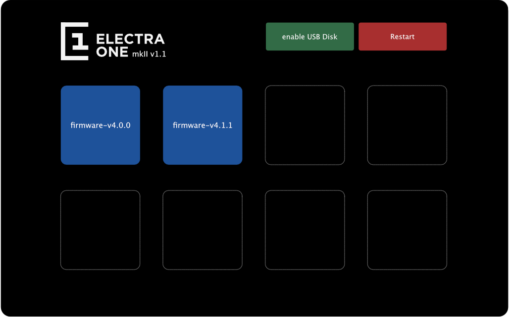

The bootloader will start, and firmware-v4.1.1 will appear in the list of available firmware images:
Firmware uploaded
8. Apply the update
Tap the blue tile labeled firmware-v4.1.1 to begin the update process.
